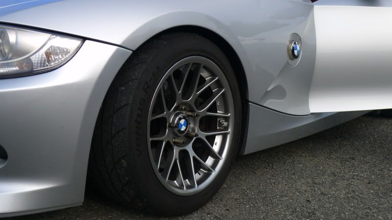

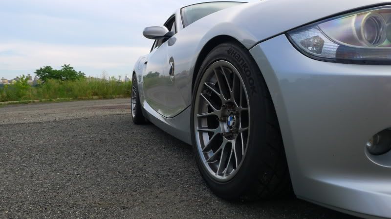

    Apex Arc8 17x9.5 et35 square, Hankook RS-3 255/40. Lowered approx 1" all around, camber plates and 5mm spacer used up front. This seems like the max you can push on our cars. NO rub during normal driving, rubbing front right liner on the track.
    http://www.zpost.com/forums/showthread.php?t=398990&page=5

    покажи дицки)
  12. amojnoya
    amojnoya Абориген
    Регистрация:
    29 апр 2013
    2,895
    ЮАР
    У него развал. Смотрим внимательно
